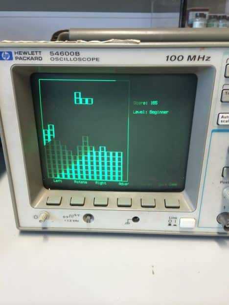

guja011 Napisano Decembar 3, 2015 Share #87 Napisano Decembar 3, 2015 tetris Link to comment Podeli na ovim sajtovima More sharing options...
