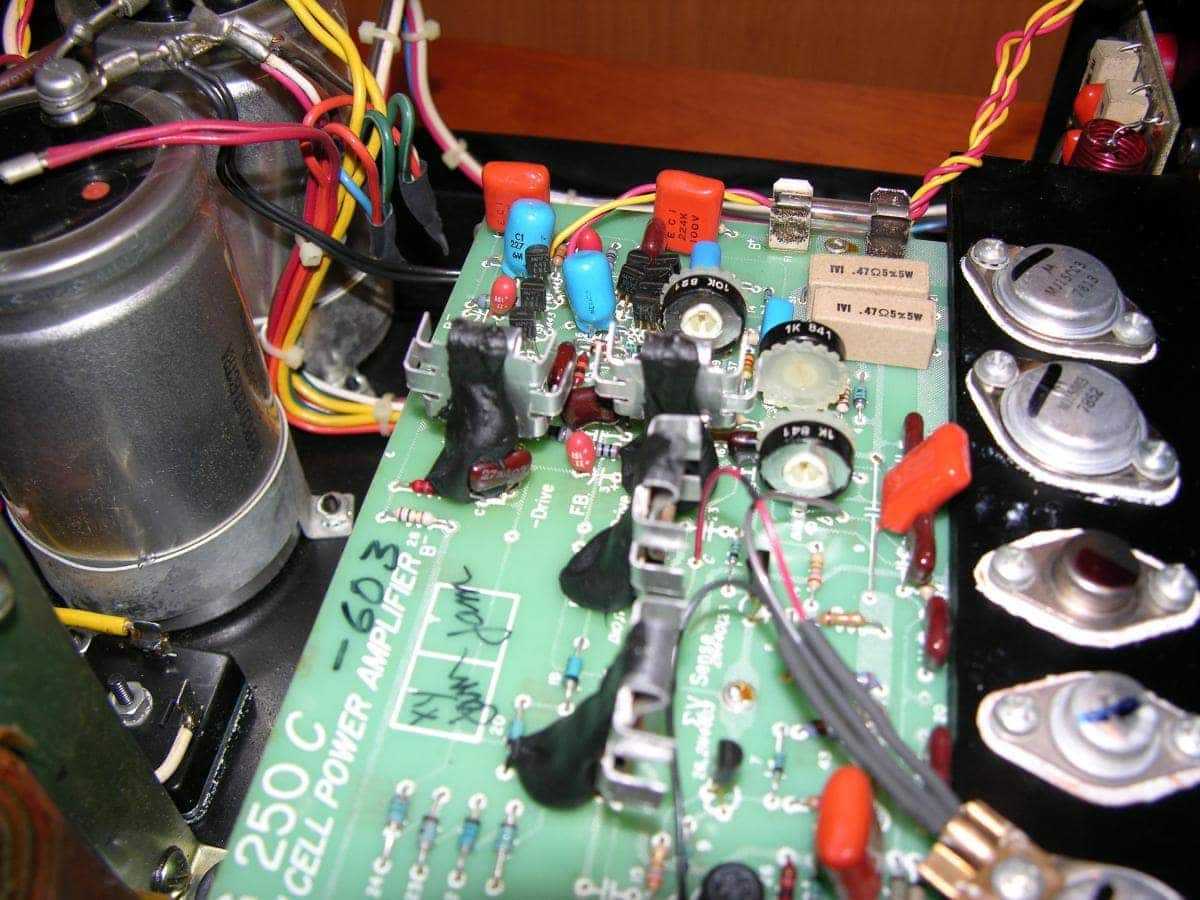

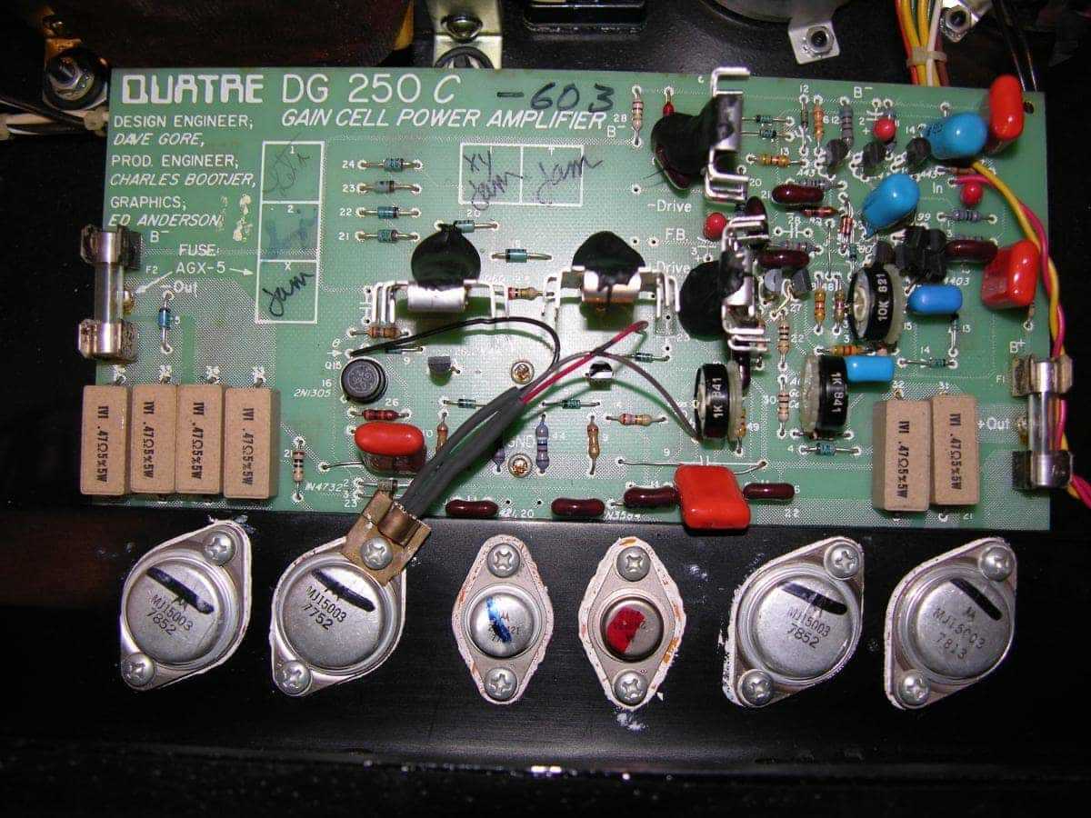

U tekstu na prvoj fotografiji piše: "The gain cell concept was developed by Dave Gore..."
